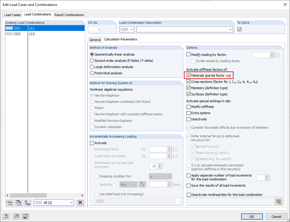

    Have you activated this check box in calculation parameters?
    Gamma_M
    This reduces the stiffness by gamma_M and increases the deflection.
