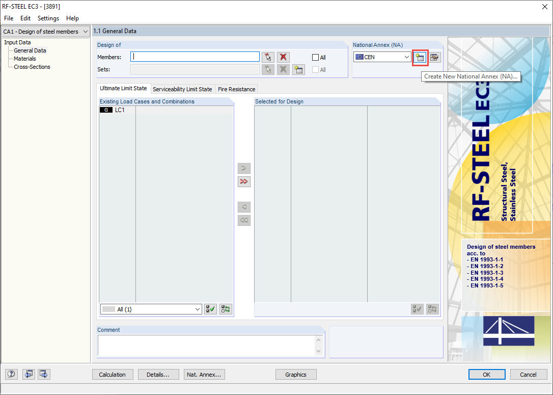

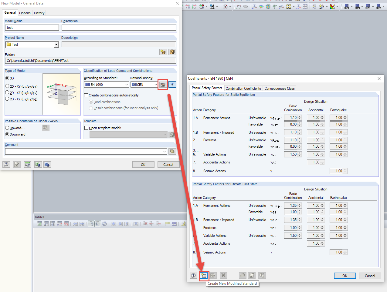

        it is not possible to create completely new codes. However, it is possible to adapt existing codes in many places. This is how it works, for example, with combinations:

        Similar options are also available for the design modules:
        RF-STEEL-EC3
