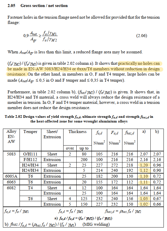

    Hello I have a question about eurocode checks for aluminium beam sections perfomed in DLUBAL.
    Is it possible to specify holes on specific section positions (i.e. perform eurocode 9 checks with the net section reduction due to holes)?
    For instance, for the bending moment, the application of eq. 6.24 of EN 1999-1.

      Altough code checks for aluminium, considering all possible cases, are rather involved (especially if partial HAZ zones are present within a section), the holes are one of the most important aspects of some aluminium alloys (i.e. dominate the resistance). I hope you will consider implementing this feature.

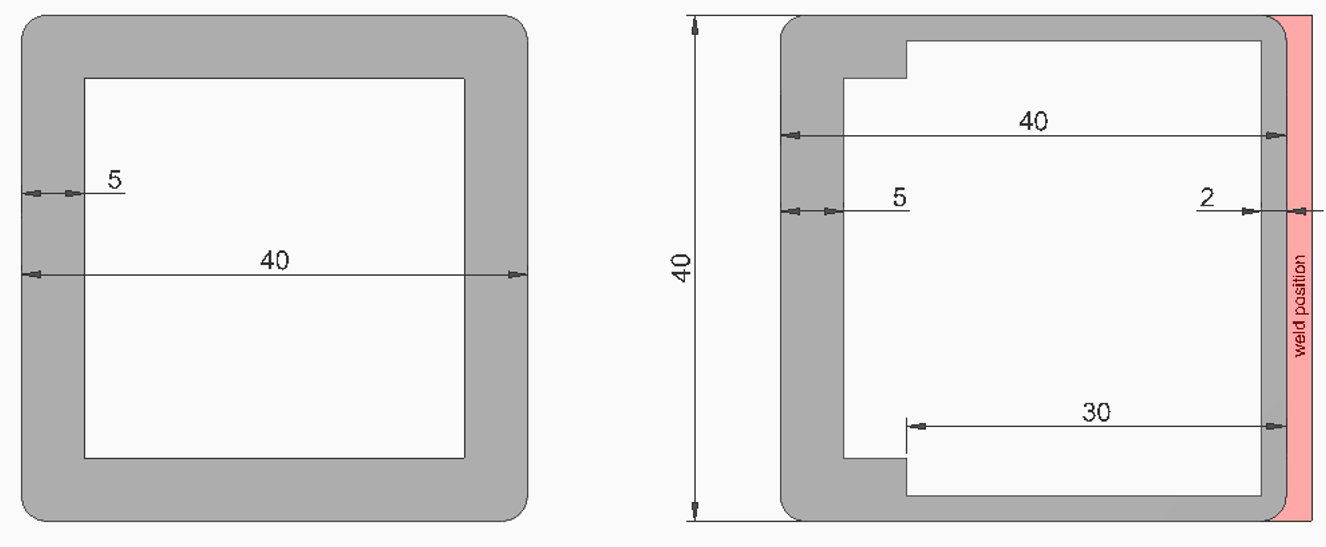

      At the moment I perform nearly all code checks manually, due to the many possible cases. For instance, if I need to calculate the resistance of a section partially softened due to a transversal TIG weld (in this particular case, only on the right side of the section: herebelow in red is shown the weld position), I have to compute section properties of the "partially reduced" section (considering the HAZ extension due to TIG: 30 mm).
      Click image for larger version  Name:	2.png Views:	0 Size:	31.2 KB ID:	2725
      It is a time-consuming process. Hope in the future all these possible cases will be incorporated in the dlubal design module.
