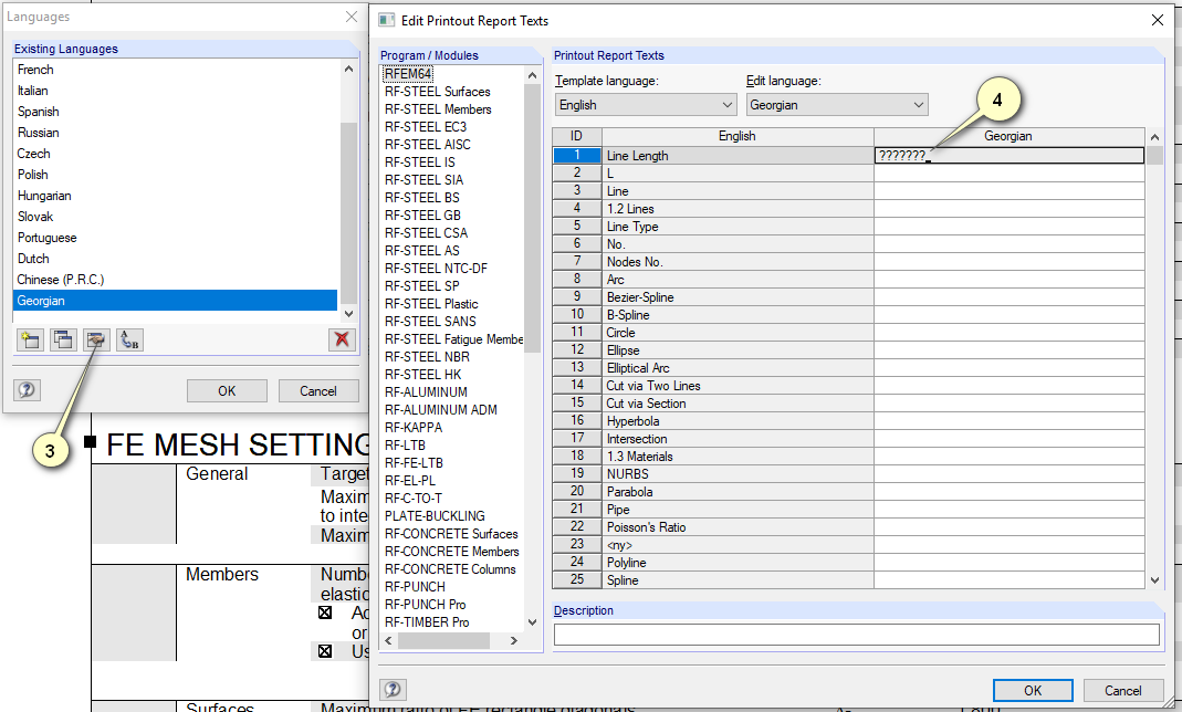

    I'm trying to translate printout report into Georgian,
    But I didn't manage - Georgian symbols appears as a "?".
    The Dlubal RFEM didn't Recognize Georgian letters.
    What is problem? I see that RFEM has Georgian language support, what I am doing wrong?
    Thanks in advance

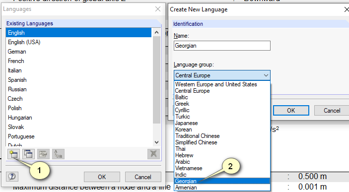

    Create new language for printout report
    Translate report into Georgian

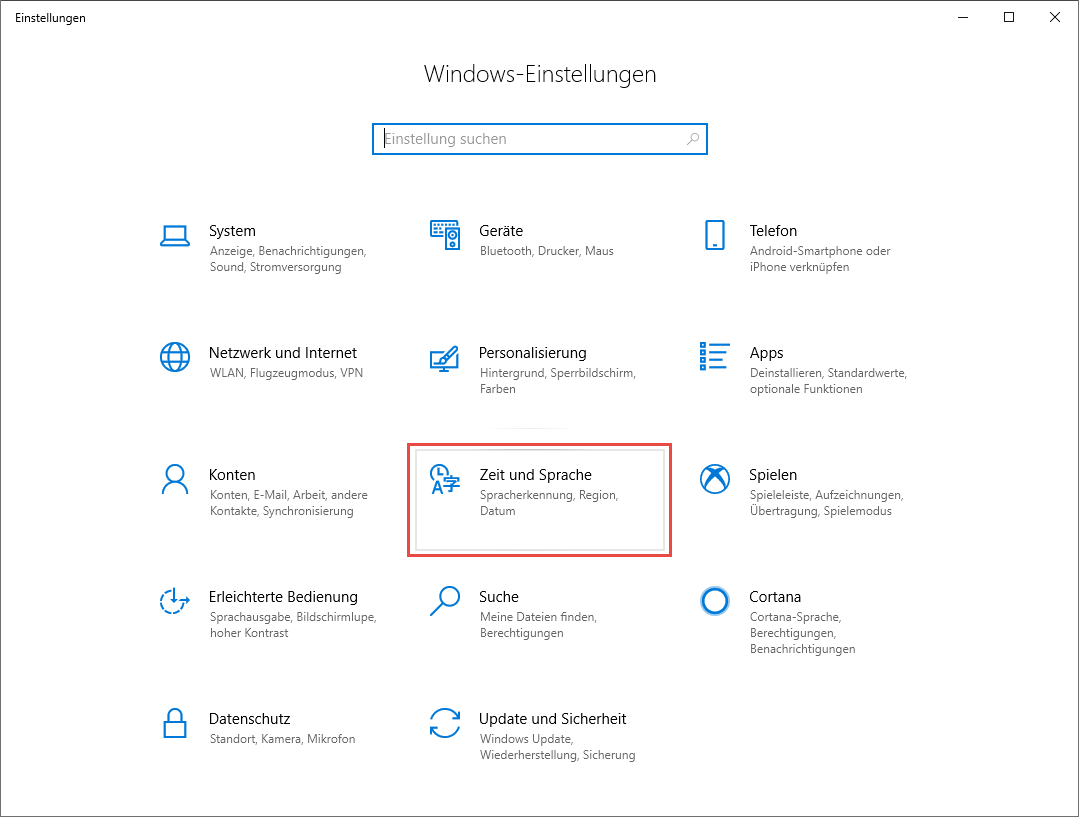

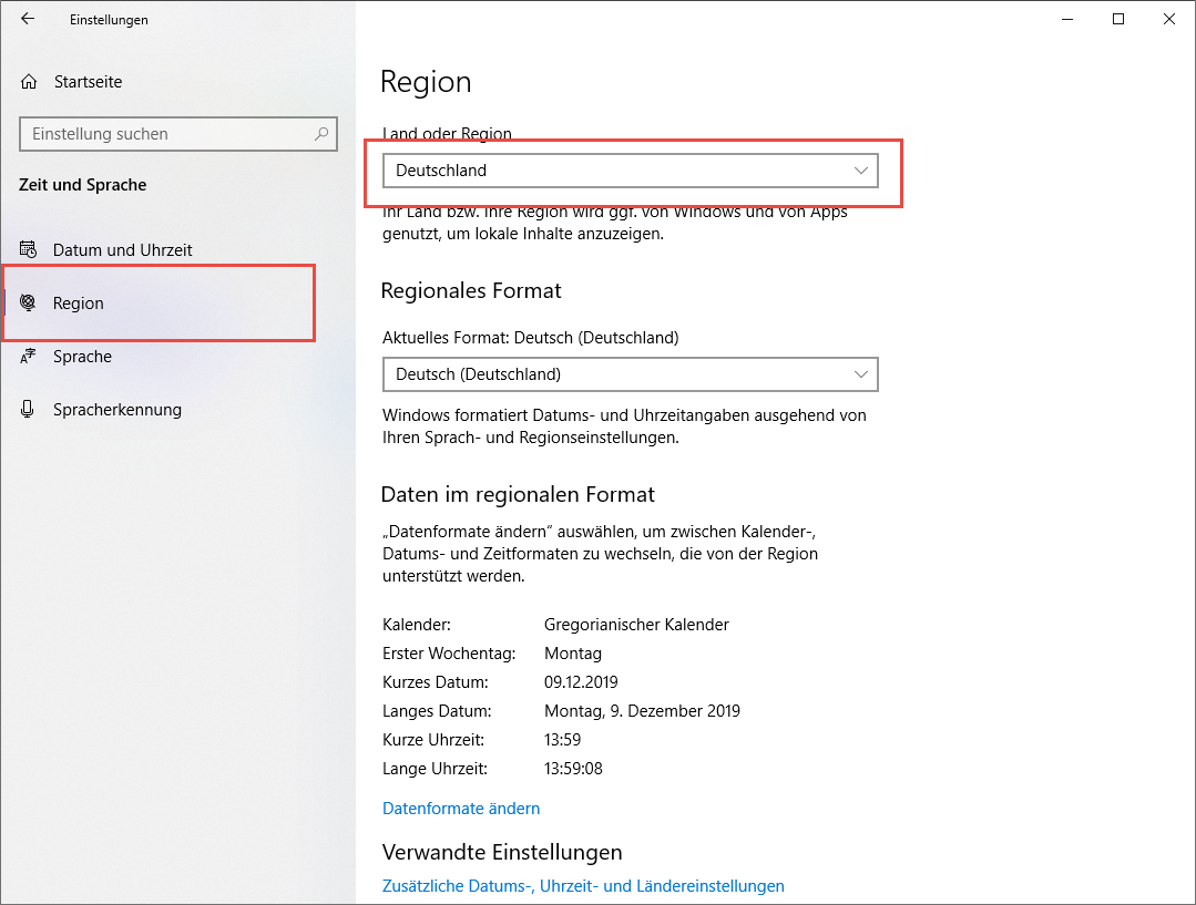

    Hello. The problem are the Windows settings. Try setting the country / region to Georgia in the Windows settings.
    Windows Settings
    Windows Settings
