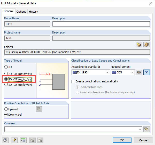

    Hello. In the pictures I see several problems.
    In RFEM you calculate three-dimensionally. In FEM-DESIGN only a plane system is calculated.
    The line support is defined so that the RFEM model can rotate around the global X axis. This is one cause of instability.
    The problem can be solved if you set the model type "2D - XZ" in the basic data of the RFEM model.
    RFEM 2D
    Alternatively, additional supports could be integrated into the 3D model to hold the model in the Y-direction.
