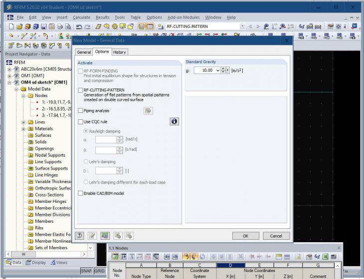

    I'm facing the following problem:
    When I'm importing for example a STEP or IGES file, the Form-Finding module is deactivated.
    Teh files are generated in soildworks.
    Are there any formats that can be imported and used to make a model, or are there some settings or restrictions to the model? Klicke auf die Grafik für eine vergrößerte Ansicht

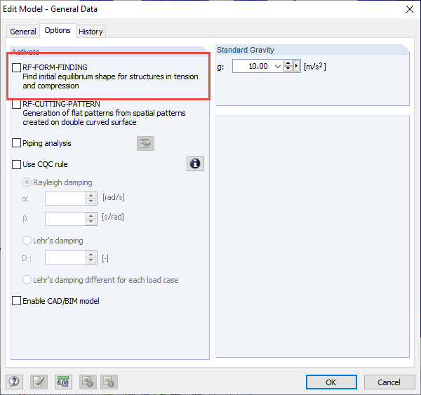

    Hello Tomasz.
    The checkbox for RF-FORMFINDING is deactivated directly during import.
    However, after the file is imported, RF-FORMFINDING can be activated.

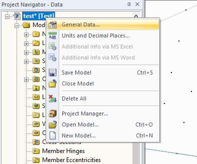

    Click with the right mouse button:
    General Data
    RF-FORMFINDING
