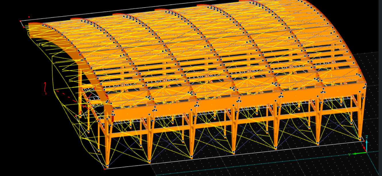

    Im having some problems related with the stability of my structure.
    It is braced completely but it seems it is not enough since the critical factor in RF STAB is less than 10 (according to eurocode), so the risk of buckling is quite real.
    Any ideas?
    Hi,

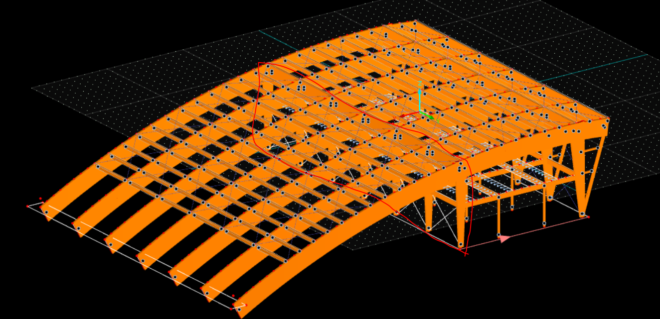

    As I can see you don't have rods in the marked row (111.png), only lines. Also you can see it in first mode shape (222.png).
