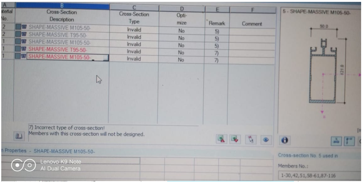

    in RF- Aluminium ADM there is a problem in aluminium section import from shape massive the section appear and imported but said (incorrect type of cross section)

    I'm not sure if shape massive is compatible with the module. Maybe better using shape-thin.
    Regards,
    Andy
      Hello, yes, Andy is right. SHAPE-MASSIVE cross sections cannot be calculated in RF-ALUMINIUM ADM. The problem is the c/t ratios. They cannot be calculated with SHAPE-MASSIVE. But they are necessary for the classification of the cross sections.
