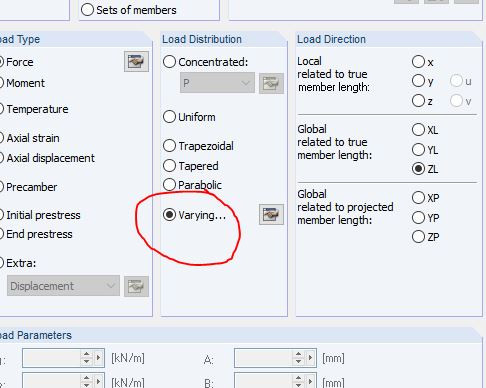

      Hi Thomas,
      Thank you for your answer.
      I checked the link but i dont see any information concerning the varying loads.
Ansichten: 140
Größe: 50,3 KB

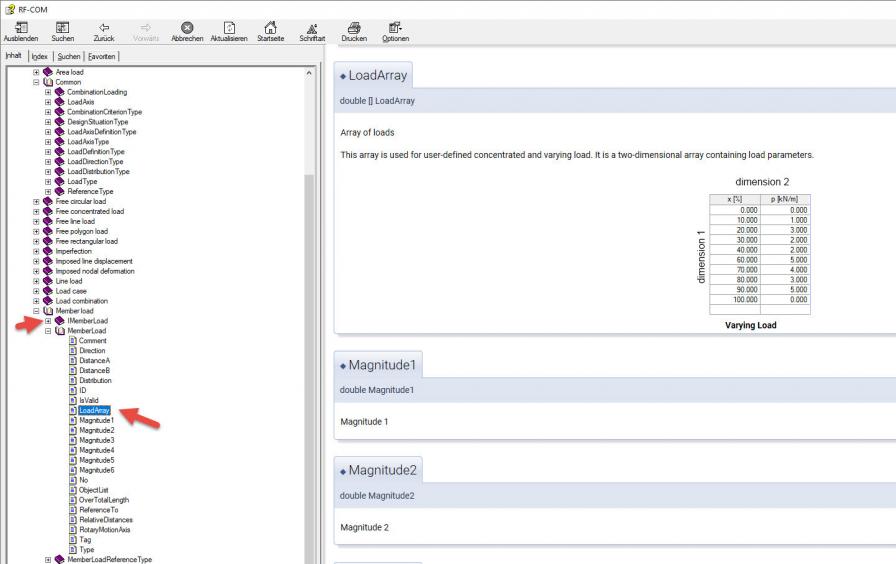

      • #4
        Hello again,
        the varying load can be used with the load array which is provided in the member load:
Ansichten: 153
Größe: 49,7 KB
        I'm happy to answer any question further available.

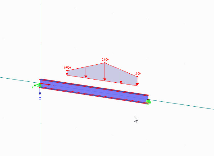

          • #6
            Here is a short example, it is the modified example from RF-COM-5 - Loads.xlsm example from the SDK:
            https://www.dlubal.com/en/support-an...ort/faq/002390
            Dim model As RFEM5.model
            Set model = GetObject(, "RFEM5.Model")
            model.GetApplication.LockLicense
            On Error GoTo e
            Dim load As RFEM5.ILoadCase
            Set load = model.GetLoads.GetLoadCase(0, AtIndex)
            Dim data(0) As RFEM5.MemberLoad
            data(0).No = 1
            data(0).ReferenceTo = MembersType
            data(0).ObjectList = "1"
            data(0).Type = ForceType
            data(0).Distribution = VaryingType
            data(0).Direction = LocalZType
            data(0).RelativeDistances = True
            Dim loadarray(0 To 2, 0 To 1) As Double
            loadarray(0, 0) = 25
            loadarray(0, 1) = 500
            loadarray(1, 0) = 60
            loadarray(1, 1) = 2000
            loadarray(2, 0) = 90
            loadarray(2, 1) = 1000
            data(0).loadarray = loadarray
            data(0).Magnitude5 = 10
            data(0).Comment = "member load 1"
            load.PrepareModification
            load.SetMemberLoads data
            load.FinishModification
            e: If Err.Number <> 0 Then MsgBox Err.Description, , Err.Source
            Set load = Nothing
            model.GetApplication.UnlockLicense
            Set model = Nothing
            End Sub
