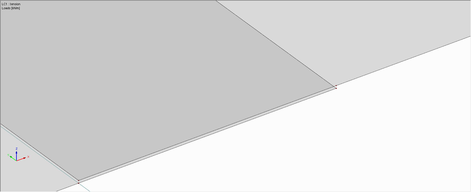

        First, I moved the one surface by 1 mm in the Z direction. This creates a gap that is equal to the thickness of the surface.
        Gap

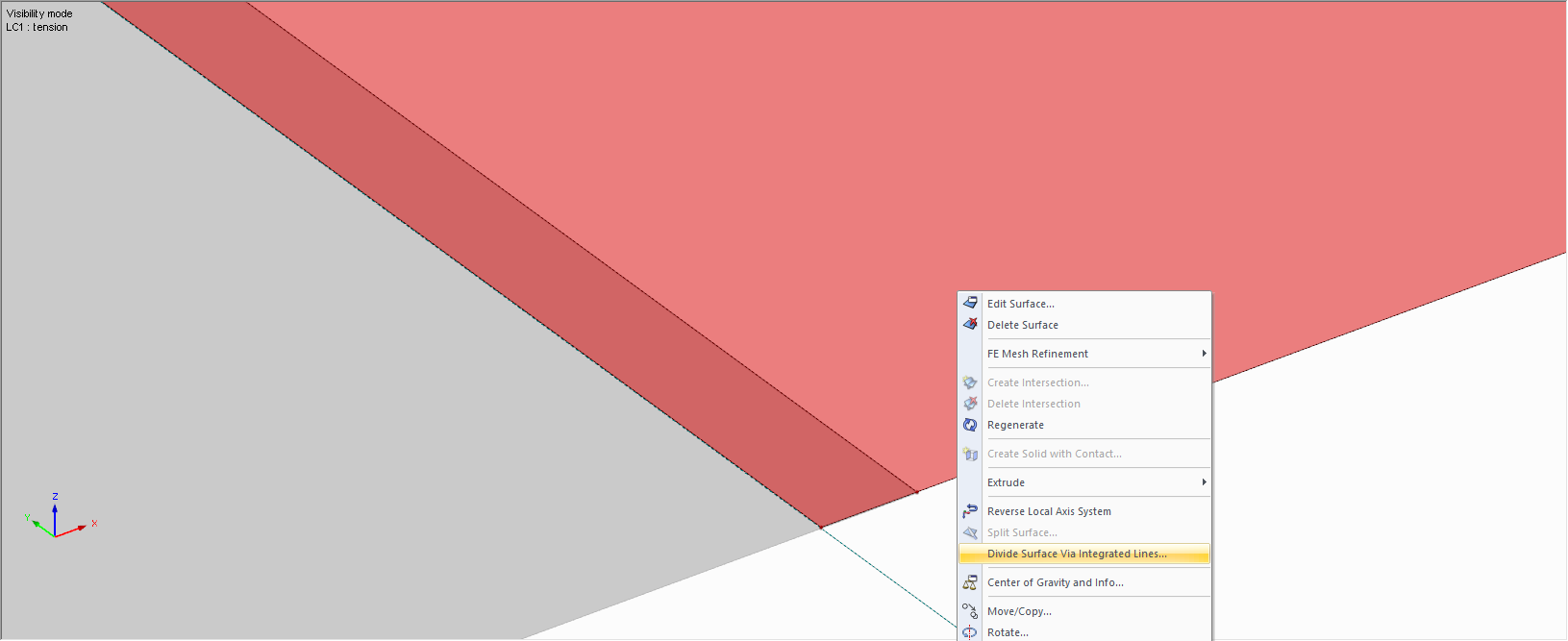

        At the end of the overlap area I drew a line and divided the surface there.
        Divide Surfaces

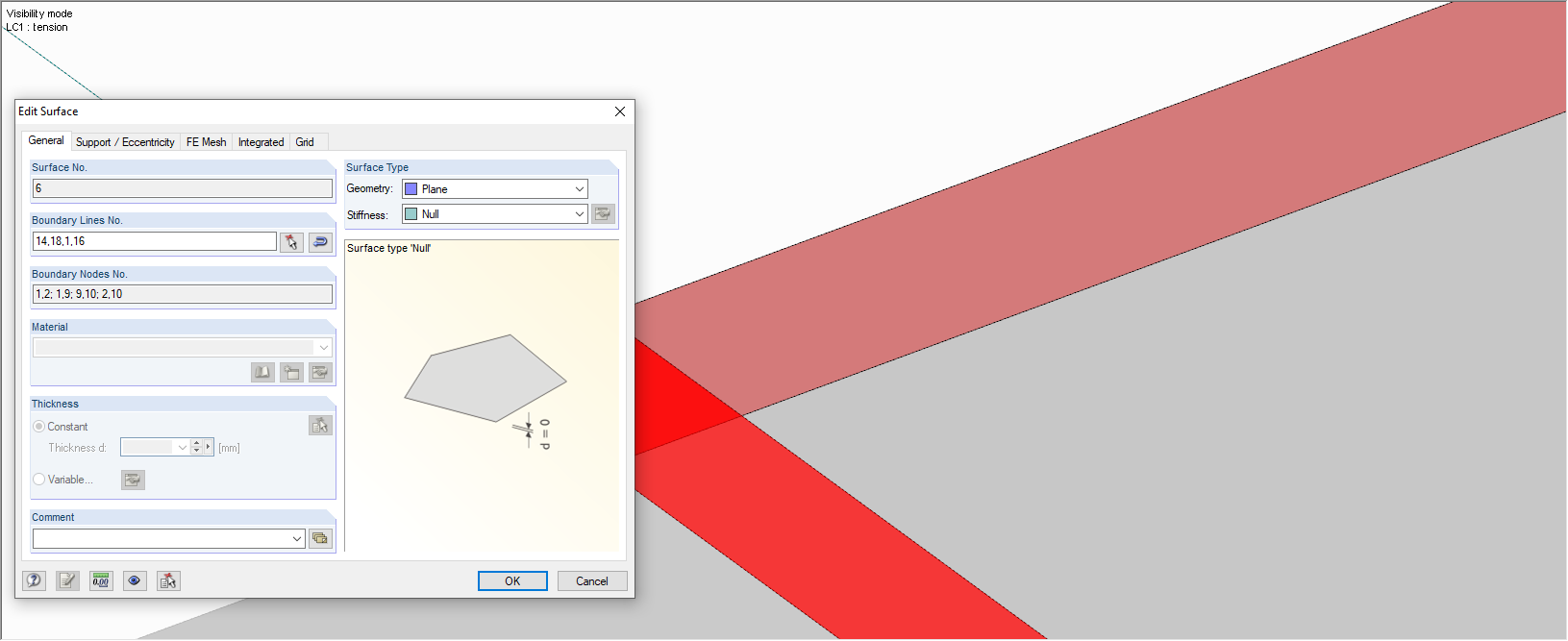

        Then I added boundary lines for the side surfaces and added the side surfaces.
        Add Surfaces

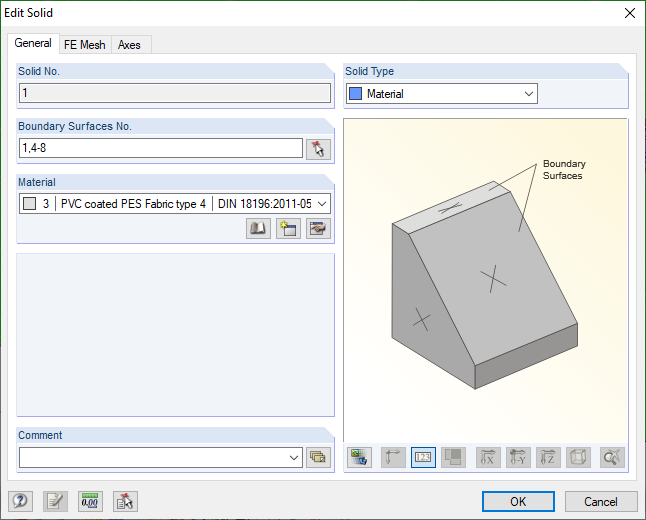

        Then I created the solid from the surfaces.
        Solid
