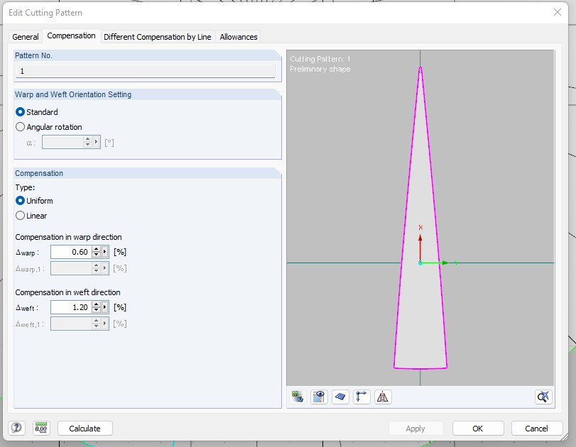

    I have a dome with 32 identical patterns, I want to compensate like in the picture, and the lowest edge not.
    How to et it to have the clamp edge original length, zero compensation, and to let start the compensation al a defined distance from the edge.
    If I use the function different compenstaion by line, how to set the weft then?

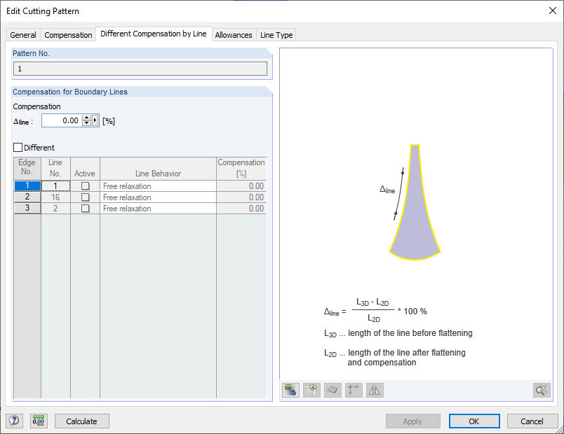

    Hello, you can set this in the "Different Compensations by Line" tab. You can either set the compensation to zero for all boundary lines. Boundary lines are the lines where no other membrane is attached. Alternatively, you can manually specify lines where compensation should be zero in this tab.
