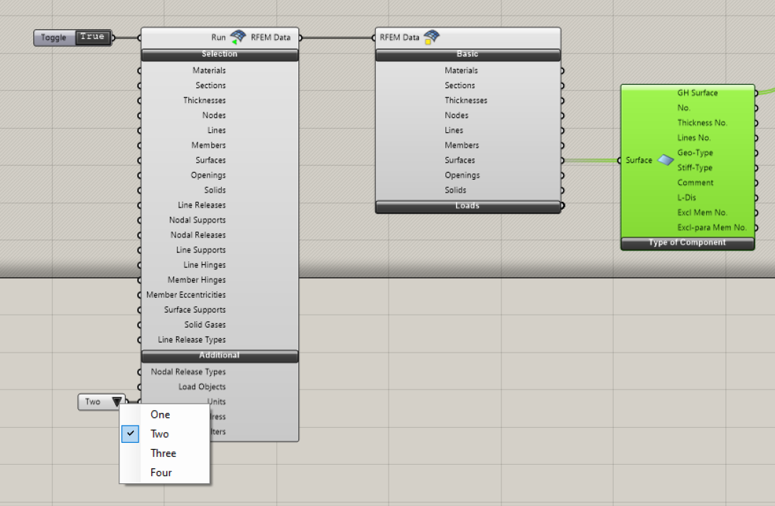

I am using Grasshopper component for importing data from RFEM to Grasshopper/Rhino
In my opinion Import Component shoud have "Flip Z Axis" option as Export component. Reason is that when geometry is imported it is on the negative Z axis plane in Rhino.
The issue can be solved by using Grasshopper mirror component
Second thing is that when I want to select "Units" I get in Value list options as One, Two, Three, etc. It would be nice to have units like mm, cm, m, etc.
