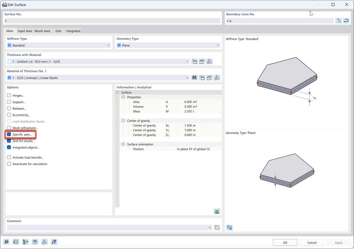

    Hello, there are surfaces that allow me to rotate the local Z axis. If I have several surfaces next to each other, the X and Y axes can still be different. This means I don't get consistent results. Why can't I rotate them too?
    Is there another way to ensure that the ISO surfaces of the results are consistent? Thanks in advance!

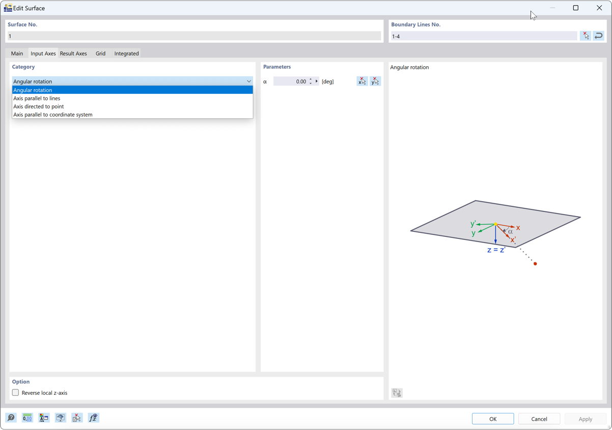

    Hello, the x and y axes can also be rotated. You can align the axes in the properties of the surfaces.

    Specific axes
