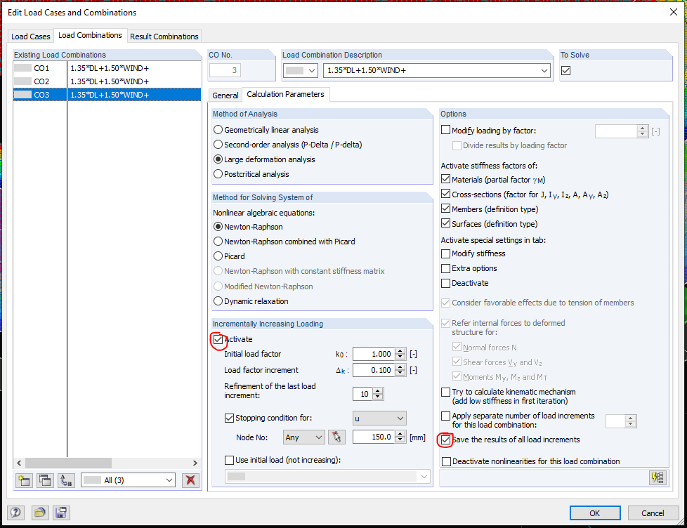

    I would like to calculate some steel shell according to EN 1993-1-6 MNA/LBA concept. Thanks for the article on your website:
    https://www.dlubal.com/en/support-an...e/001510#Refer
    In our office we have all required modules. I calculated critical load factor from the LBA but I wasn't able to calculate plastic reference resistance from the MNA.
    Could you please specify which steps I have to take to and what settings to use to read this MNA factor?
